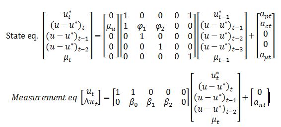

I'm a newbie in RATS and I want to estimate the NAIRU (to be precise NAWRU) using a bivariate unobserved component model in SS form.
My SS form is like in the one in the figure, where u and deltapi are the observables (unemployment and change in wage inflation)
I went through fabiani-mestre and Laubach and Williams examples (togheter with RATS manuals), but, to be honest, I'm far away from understanding how DLM works.
Is there anyone available for helping me in coding this SS?

There appear to be some typos in that. I assume you want a + between the first two components on the right-side. And is there supposed to be a 1 in the (2,1) element of the transition matrix? That looks like it should be a zero.

1. Yes, a plus is missing.
2. No, actual unemployment just equal to nawru plus un.gap.

2. I mean it is a zero.

In RATS options, the first 5-vector is your "Z". The 5 x 5 matrix is your "A". Your "F" matrix will be
1 0 0
0 1 0
0 0 0
0 0 0
0 0 1
The SW will (I assume) be a 3 x 3 diagonal matrix with three free variances. SV will be the symmetric matrix ||0.0|0.0,sigsqpi|| (or whatever you want to call that variance). C will be (since it's transposed)
1 0
1 beta0
0 beta1
0 beta2
0 0
The Z, A, SW, SV and C all have free parameters, so they'll have to be defined as FRML's of the proper type. For instance, something like:
similarly for the other system matrices. You have to do a NONLIN to define the free parameters before you can create those matrices, and you'll have to come up with some process for getting guess values for them.

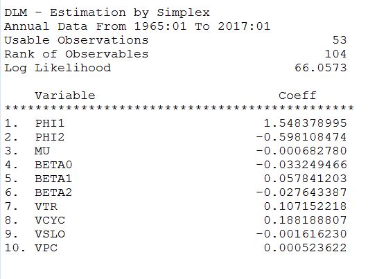

I have another issue.
My code is:
I have two problems here:
1. Variances constraints do not bite;
2. One of the variances is negative. Ho can it be possible?
M
M

SIMPLEX, by it's nature, can't handle the constraints. Instead, you have to use METHOD=BFGS---see Section 4.4 in the User's Guide.
You have four fundamental shocks for two observables. The only requirement to compute the likelihood is that the predictive covariance matrix be positive-definite, which can be true even if some of the variances are (theoretically) negative. If that's the case, then the optimum is an edge solution, which requires using constrained estimation.

Indeed with bfgs all the variances are positive and constraints are satisfied.
