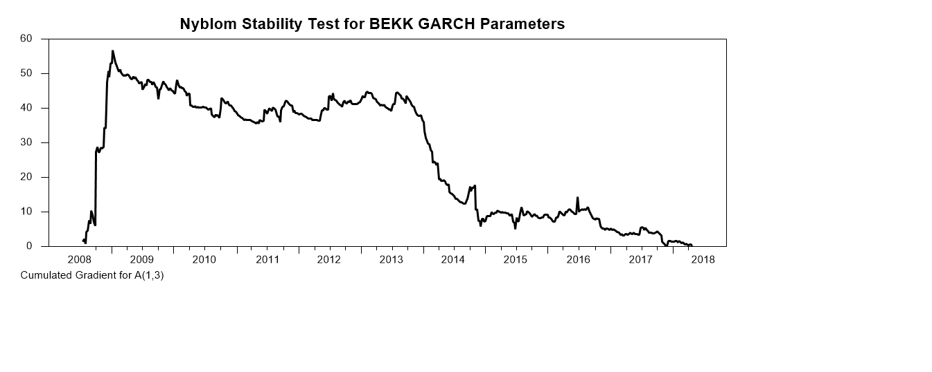

For some reason, when I run the code you provided for any dd(), I get a value of zero back. For example, I have attached the picture ("Nyblom1") of the estimated cumulated gradients for one of my parameters, A(1,2) (or, dd(36)). When I run the following code,
I get a return value of zero. From the cumulated gradient graph, we can clearly see that the maximum value is not zero. Secondly, is there a command in RATS that can identify the date associated with the maximum value? Thanks.
acc dd(36) / agrad36
sstats %regstart() %regend() abs(agrad36)
disp %maxent- Attachments
- Nyblom1.png (23.72 KiB) Viewed 94957 times
Re: Identifying Break Dates for BEKK Variance Shift Dummies
Sorry. Should be sstats(max) ... I corrected that above.
