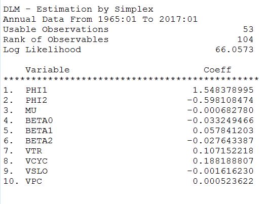

I have another issue.
My code is:
end(reset)
calendar(a) 1960:1
allocate 2017:1
open data WF2016.RAT
data(format=rats)
* Starting values
compute phi1=1.4203, phi2=-0.6216, mu=-0.0015, beta0=-0.0339, beta1=0.0560, beta2=-0.0272
compute vtr=0.1, vcyc=0.11, vslo=0.02, vpc=0.0004837
compute LB=0, UBvtr=0.1, UBvcyc=0.11, LBvslo=0.02, UBvslo=0.035, UBvpc=0.000816139288671913
nonlin(parmset=coeff) phi1 phi2 mu beta0 beta1 beta2
nonlin(parmset=vlist) vtr vcyc vslo vpc
nonlin(parmset=varia) vtr>=LB vtr<=UBvtr vcyc>=LB vcyc<=UBvcyc vslo>=LBvslo vslo<=UBvslo $
							 vpc>=LB vpc<=UBvpc
decl frml[rect] af
frml af = ||1.0 ,0.0, 0.0,0.0,1.0|$
            0.0,phi1,phi2,0.0,0.0|$
            0.0, 1.0, 0.0,0.0,0.0|$
            0.0, 0.0, 1.0,0.0,0.0|$
            0.0, 0.0, 0.0,0.0,1.0||
decl frml[vector] zf
frml zf = ||0.0,mu,0.0,0.0,0.0||
decl rect ff
compute ff=||1.0,0.0,0.0|$
				 0.0,1.0,0.0|$
				 0.0,0.0,0.0|$
				 0.0,0.0,0.0|$
				 0.0,0.0,1.0||
decl frml[symmetric] swf
frml swf = ||vtr, 0.0, 0.0|$
				 0.0,vcyc, 0.0|$
				 0.0, 0.0,vslo||
decl frml[rect] cf
frml cf = ||1.0,  0.0|$
				1.0,beta0|$
				0.0,beta1|$
				0.0,beta2|$
				0.0,  0.0||
decl frml[symmetric] svf
frml svf = ||0.0, 0.0|$
      		 0.0, vpc||
decl frml[vector] yf
frml yf =||u,ddw||
dlm(presample=ergodic,parmset=coeff+vlist+varia, print,y=tr(yf), a=af, z=zf, f=ff, sw=swf, $
c=cf, sv=svf, method=simplex) 1965:1 2017:1 xstates vstates
I have two problems here:
1. Variances constraints do not bite;
2. One of the variances is negative.
Ho can it be possible?
M
Re: DLM for UCM-NAWRU
Posted: Mon Feb 22, 2016 10:10 am
SIMPLEX, by it's nature, can't handle the constraints. Instead, you have to use METHOD=BFGS---see Section 4.4 in the User's Guide.
You have four fundamental shocks for two observables. The only requirement to compute the likelihood is that the predictive covariance matrix be positive-definite, which can be true even if some of the variances are (theoretically) negative. If that's the case, then the optimum is an edge solution, which requires using constrained estimation.
Posted: Mon Feb 22, 2016 10:36 am
by fioramanti
Indeed with bfgs all the variances are positive and constraints are satisfied.
M
