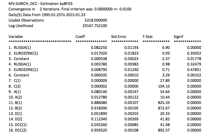

Please accept my sincere apologies for upcoming questions, since I´m quite new to DCC-GARCH model and I just started using Rats.
I am trying to find if two stock market indices are integrated with each other, and apparently one step DCC procedure (general) can be used for this.
When using the wizard, dependent variables are log returns of these two separated stock markets. But should I add something on "mean model variables" besides "constant" ? And should I add also something in "variance shift variables" ?
I got this task from my professor, but he´s now off-duty, so I have been learning by doing, reading this page, manual and etc. He said that the outcome should be something like in attachment.
Thanks for any comment!

- dcc-garch.png (107.69 KiB) Viewed 741344 times
Re: Beginner problems in DCC-GARCH
Just to understand, was the attachment done with a different data set?
What you're looking at would have been done with mean model variables russia{1} eurozone{1} in addition to CONSTANT. It's model type DCC, with the "Asymmetric Effects" checkbox clicked on. There are no variance shifts.

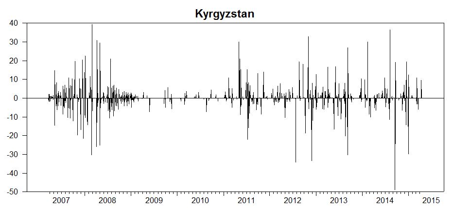

I got the results for three country pairs. For Kyrgyzstan, I think there´s not much to do, since their price index is what it is:
- Kyrgyzstan_returns.JPG (50.89 KiB) Viewed 741294 times
It looks like about half the days are true zeros. Is that correct?

Yes, that´s correct. Seems that there´s nothing happening for many days. Also tried for shorter period, but still does not work.
There is *some* literature on volatility for thinly traded markets. However, it will be quite a bit more demanding than fitting well-known GARCH models. Have you thought about switching to weekly returns?

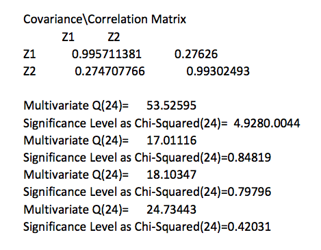

But I have still few questions. They are from slightly different area ( I did not wan´t to make new topic).
When calculating Covariance∖Correlation matrix, for example between Russia (lrus) and Ukraine (lukr), I got the following:
Covariance∖Correlation Matrix
LRUS LUKR
LRUS 5.379964 0.34715
LUKR 1.798606 4.98946
Should it be close to one between LRUS & LRUS etc. ?
The second question is about L-B Q values; how I can calculate them?
Here´s again example of the desired outcome:
- Näyttökuva 2015-07-31 kello 17.12.23.png (66.08 KiB) Viewed 741278 times
It is what it is. That's not really something that anyone not researching those particular markets could tell you.juustone wrote:Thank you Tom for your help! Also the last data set worked well after your suggestion.

Unfortunately, it's hard to tell what's being done from just the output. I'm guessing that output is generated using the univariate standardized residuals. From the GARCHMV.RPF example, the calculates (three sets) of residuals for a different model. It's the RSERIES and MVHSERIES options that are needed.juustone wrote: The second question is about L-B Q values; how I can calculate them?
* Diagnostics on (univariate) standardized residuals
garch(model=var1,mv=bekk,asymmetric,p=1,q=1,distrib=t,$
pmethod=simplex,piters=10,iters=500,$
rseries=rs,mvhseries=hhs,stdresids=zu,derives=dd)
set z1 = rs(1)/sqrt(hhs(1,1))
set z2 = rs(2)/sqrt(hhs(2,2))
set z3 = rs(3)/sqrt(hhs(3,3))
VCV
# z1 z2
The others are probably done with @REGCORRS procedures applied to z1 and its square, z2 and its square. However, the @BDINDTESTS procedures in GARCHMV.RPF do those two tests and more, and label them better.

Somehow I can´t make the Q-test. The thing is that I´m trying to make it to pairwise series. For single serie, it worked.
Is it possible to use wizard on this ?
You want to use @MVQSTAT for a joint test, but that needs to be applied to a jointly standardized set of residuals. The diagnostics for multivariate GARCH models are described in Section 9.4.6 of the User's Guide. This is one of the multivariate diagnostics.
