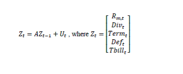

Hi Tom. I am trying to triangularize a VAR(1) system in a way that the innovations in DIV,TREM,DEF,and TBILL are orthogonal to the innovation in Rm. In addition, I need to scale all the innovations to have the same variance as the innovation in the Rm. Could you please kindly give me some tips about how to do the triangularization and scaling? Thank you for your help.

Hi Tom, Thank you for your reply. Actually, I am trying to replicate what Petkova (2006) did in her paper. According to the author, she triangularize the VAR system in the way that the innovation in the Rm,t is unaffected , the orthologonalized innovation in the DIV is the component of the original DIV innovation orthogonal to the Rm,t and so on. The orthogonalized innovation to DIV is a change in the dividend/price ratio with no change in the market return; therefore, it can be interpreted as a shock to the dividend. Similarly, shocks to the term spread, default spread, and short-term rate are all orthogonal to the contemporaneous stock market return (Rm,t). As in Campbell (1996), the author also scale all innovations to have the same variance as the innovation in the Rm,t.
My way to remove the effect of Rm,t on other variables is to run the VAR system and treating the Rm,t and its lags as exogenous variables in the system. It will be helpful if you could kindly help me to learn how Petkova did exactly in her study. Many Thanks.
