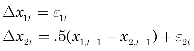

You're looking at one equation out of a VECM. The loading is probably significant in the other equation. For instance, if
then the two variables are cointegrated, but all the adjustment is done by x2. If you run a ECM on x1, you'll get a zero coefficient on the cointegrating vector.
