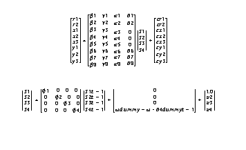

I understand that assigning appropriate initial values could play a big role in running state-space model. However, it is always difficult for me to give initial values when I am running state-space model. I would like to know how you will assign the initial values if you had the attached model.

Sorry for the late reply. here is the example model
- example model.png (5.61 KiB) Viewed 9575 times

Your model has no way to distinguish the first three states. If one turns out to be redundant, you're going to have a very tough time trying to estimate that. You also have unidentified scales on the 2nd and 3rd states.
Probably the best way to get guess values is to get the first four principal components, and do AR(1)'s on each to get guesses for the transition parameters, then linear regressions to get the loadings. That will get the scales right on the coefficients, but might not get the correct 4th state.
