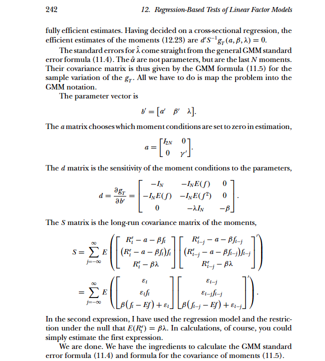

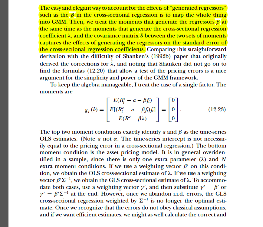

Basically, I want to estimate an asset pricing model using GMM based on the book of Cochrane:
But i don't know how to properly specify the moment conditions.
It is about implementing a linear factor asset pricing model.
II have nine Fama-French portfolios and three risk factors.
I need to run a time-series regressions to get the coefficient estimates on three risk factors for each of the nine portfolio and the residuals should be orthogonal to the risk factors. This is the first and second moment conditions as in the screenshot of the book.(equation 12.23)
Then i need to run a cross-section regression. that is to regress coefficient estimates from the above regression (which becomes the right hand variables) on the average excess return of the portfolios. this is the third moment conditions.
The reason for using GMM is that the covariance matrix is supposed to take care the generated regressor problem and gives me robust inference.

I think what i need to do is to saved the estimated coefficients and the VCV of the parameter estimates and somehow tell rats to use that information in estimating the third moment conditions.
I attaches the the screenshot from cochrane's book where he specifies the moment conditions and the spreadsheet.

Do you know if he has examples with data for that approach? So far as I can tell, the GMM weight matrix is singular by construction. The program below theoretically does what he describes, but the weight matrix is deficient rank so the estimation doesn't work. (No matter what the values of "lambda" are, there are some linear combinations of the TS conditions and CS conditions which wash out).

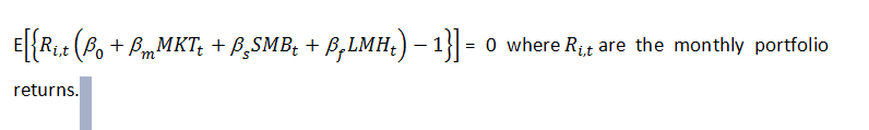

So i have been trying to use GMM with the time-series(Assuming SDF is a linear combination of the three risk factors) and compare the
results to the OLS estimates.

I attach a new excel file and the pricing error equation i use to do the GMM.
I would like to use Hansen's optimal weighting matrix and 1 as instruments and Newey-West estimator.
I include the codes, but i don't think that they are right, could you help me with it.

You want ZUDEP on the NLSYSTEM instruction, but other than that, it looks fine. However, your MedFMedium series isn't right---it looks like net returns rather than gross.
