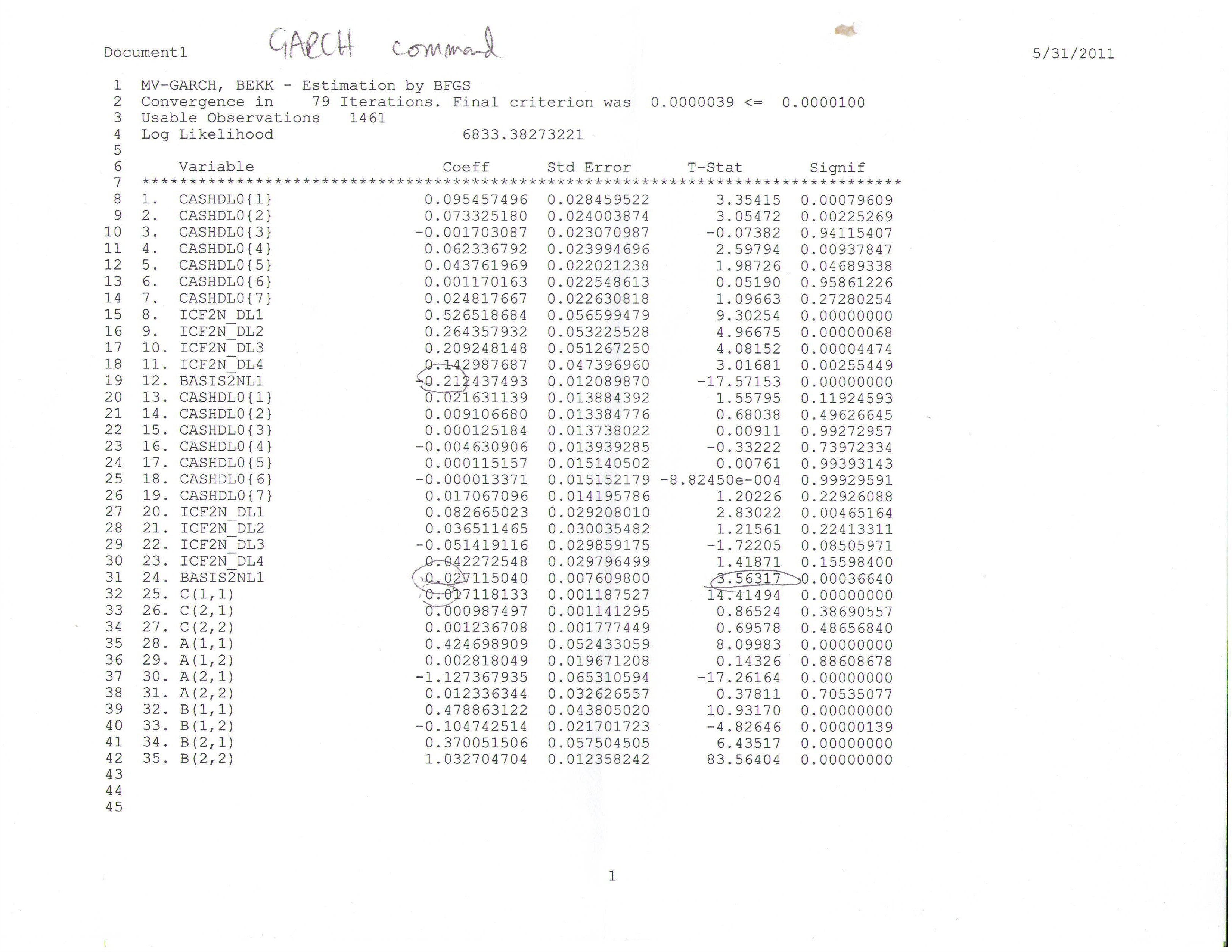

This is a follow-up on our conversation from this morning. I am attaching a RATS code that is giving me different results in RATS 7.3 and RATS 8.0.
In 7.3, my results with MAXIMIZE are essentially the same as with GARCH command. In 8.0, I get pretty much the same results with MAXIMIZE as I did in 7.3, but GARCH command is giving me results that are sufficiently different to cause some worry.
The code is below, and code, output and scanned output from 7.3 (I cannot re-run it, as I was running my code on a computer that was not mine).
Can you please test if you are also getting different results depending on the version? If yes, what is the cause for these discrepancies, and how can I eliminate them?

Output in 7.3
Output in 7.3
RATS 7.3 GARCH results.JPG (1.01 MiB) Viewed 4593 times
