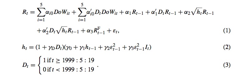

I am trying to use RATS to estimate the coefficients for the above GJR Garch specification, used by Bohl & Brzeszczynski, 2006 in the attached article.
But I am facing some difficulties with the instructions,
The following is what i have so far, but how about
and
how can i instruct rats to include the above coefficients in the following code?
additionally, how about the Xregressors in the variance equation.
GARCH(P=1,Q=1,XREGRESSORS,REGRESSORS,Pmethod=sim,piters=20,resids=u,hseries=h,distrib=1,asymmetric,i=drift,method=1) / %S('r'+%l(i))
# Constant DoW1 DoW2 DoW3 Dow4 DoW5 DDoW1 DDoW2 DDoW3 DDow4 DDoW5 R(subscript t-1) (D(subscript)R(subscriptt-1)) R(subscript f)

For many reasons, you can't use GARCH to estimate that---there are just too many effects that have to be generated as part of the recursion. You'll have to use a MAXIMIZE set up. You should look at the replication file for Baillie and Bollerslev, "The Message in Daily Exchange Rates: A Conditional Variance Tale", JBES 1989, vol 7, pp 297-305 which uses day of the week effects.
