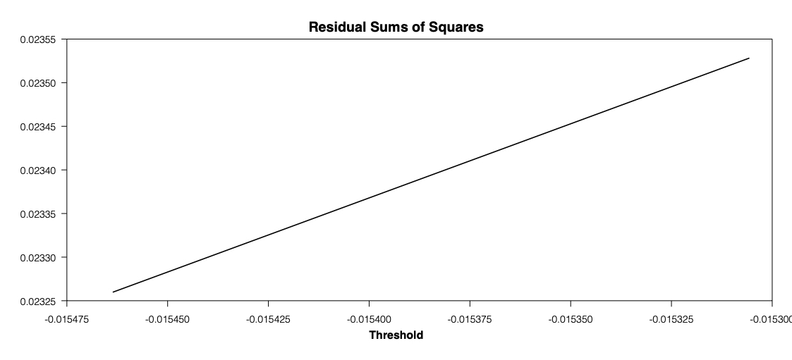

Hello Dear Tom,
I have a question about TAR model. My series is Z and period is from 2003:2 to 2025:2 (monthly/ 265 observations).
The lag order of Z is 9. That's, Z ~AR(9) by AIC. I have determined transition variable as Z{2}.
Now, I need to apply Chan's method to select threshold value. That's, for linear attractor model, I need to find best SSQ and threshold values. For that, I wrote down two RATs codes, but I got wrong results.

My question:
The code gives error as follows:
Can't Interpret SERIES[REAL] = SERIES[REAL]
## SX27. Illegal Combination of Data Types for Operation
>>>> + fix(.15*%nobs) ,<<<<
When I wrote down "SET low = 2003:02 + fix(.15*%nobs) , high = 2025:02 - fix(.15*%nobs)" in the first code, then I got an incorrect result. And I got the following wrong graph which I attached.
How can I correct these codes? or Which code should I use?
Thank you so much for your helps,
Best.

I posted my whole code. And I attached dataset both in Excel file and in RATSdata format. I could not solve the problem. How can I deal with this problem. Thank you so much.
Best regards.
