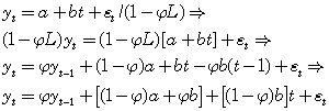

Re: simulate, estimate and forecast OOS univariate models incorporating a linear trend term
This shows the conversion of the AR+trend from the BOXJENK form (first line) to the LINREG form (last). As you can see, the coefficients on the trend terms are completely different in the two. You can't add shifts to a dynamic model and think that they have the same effect as they would in a static model.
Note that the two are modeling exactly the same thing, just in a different form. The BOXJENK form is more "structural" in the sense that the a+bt is actually the process mean while the coefficients in the LINREG form are a complicated non-linear interaction of the structural parameters. It is not as handy for forecasting as it breaks the information into two pieces while the reduced form at the end has a single expression, which is why that is what is produced by BOXJENK(DEFINE=xxx).

TomDoan wrote: ↑Thu Nov 28, 2024 7:50 am This shows the conversion of the AR+trend from the BOXJENK form (first line) to the LINREG form (last). As you can see, the coefficients on the trend terms are completely different in the two. You can't add shifts to a dynamic model and think that they have the same effect as they would in a static model.
Therefore, BOXJENK is better than LINREG - and I should be using BOXJENK REGRESSORS for models y2 to y5 as I am estimating ARMAX models, and GLS for model y1. Right?
I have included a TRENDSQ term to the 4th, y4: quadratic trend process and removed the constant.
    Variable                        Coeff      Std Error      T-Stat      Signif
1.  AR{1}                         0.982196673  0.008053562    121.95805  0.00000000
2.  TREND                        10.036218055  0.018950239    529.60905  0.00000000
3.  TRENDSQ                       0.025009592  0.000032593    767.33484  0.00000000
The AR{1} term is near 1.0, however TREND is "a" and TRENDSQ is "b", why is that?
My suggestion is that you go back to Nelson and Plosser and read the mathematical background. They go over the difference between trend stationary and difference stationary series (basically what you are simulating here) and how the wrong choice can cause problems (what you are discovering here).
Note that @BJDIFF is not designed to allow for a trend stationary series.
