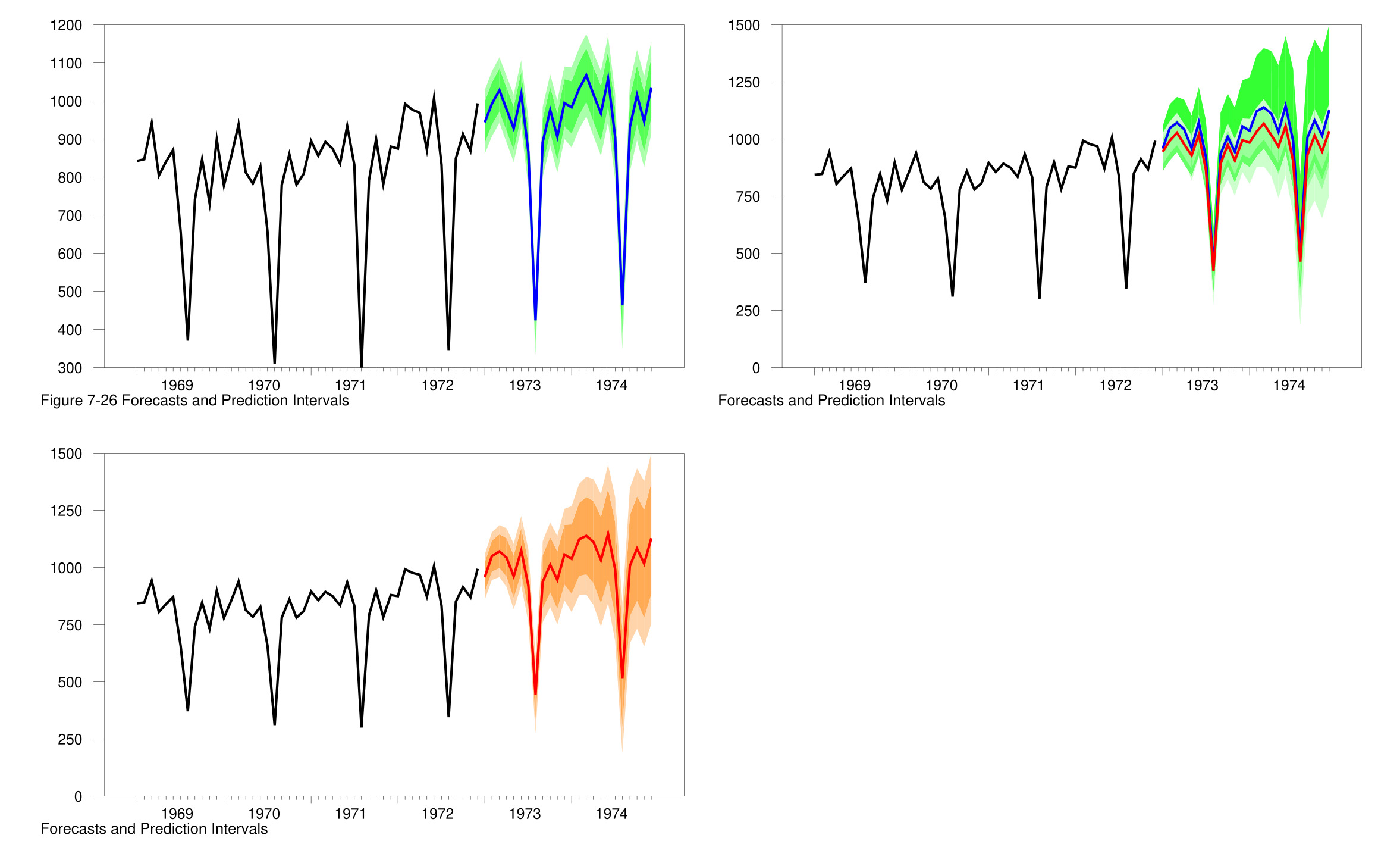

I have specified a different model with much wider fans:
and plotted 3 graphs. The green graph should appear on-top-of the orange graph (the orange fans should be visible, as are both the point forecasts); the 3rd graph being:
boxjenk(diffs=1,sdiffs=1,ar=4,ma=4,sma=1,maxl,define=weq_M2) writingCode: Select all

- ac_mwhp366.jpg (299.3 KiB) Viewed 75151 times
Re: Superimposing 2 fan charts
That's not how the fan style works. It does various shades of color of the first covered series (evenly scaling down the R, G and B components of the color). You can do two separate fans by using STYLE=FAN and OVERLAY=FAN. However, note that FAN (and BAR and a few others) are "painted" styles---they completely cover all the pixels in a region. Because it makes little sense to do lines and then a paint style, RATS will render the paint style first, then do the lines over that. However, if you do two painted styles, the first is covered by the second---all that would be visible would be any piece that is completely outside the region covered by the second, which won't be anything resembling a "fan".
