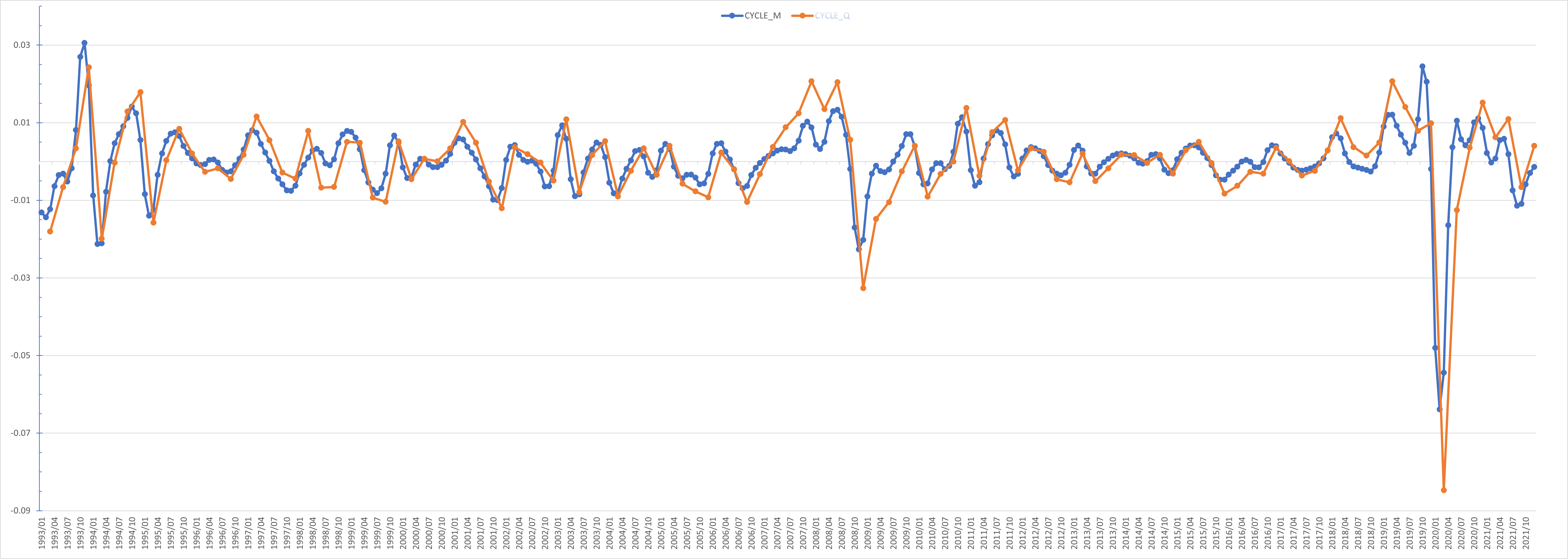

Yes, I do. In my code, I use
GRAPH(STYLE=LINE,OVERLAY=dot,ovsamescale,KEY=BELOW) 2
# MGDP 1947:01 1950:12
# GDP 1947:01 1950:12
In fact, I want to get two lines., graph attached is done by MS EXCEL.
I want to graph directly by Rats.
Best Regard
Hardmann

Re: How to graph two time series with different frequent?
If you do lines, it will do ---- lines in connecting the quarterly numbers. I'm really not sure why you would want to do lines connecting the quarterly numbers. You've gone to considerable effort to come up with a monthly distribution of the GDP numbers and then you want to show them the same way as a strictly artificial linear interpolation.
