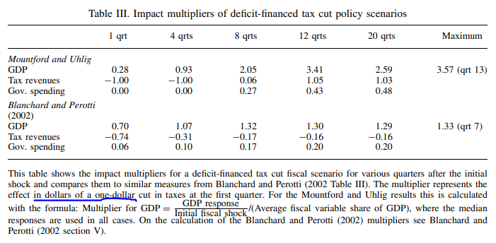

Mountford & Uhlig --> see attachment
Do you know if there is "one" correct way to calculate the impact multipliers for sign restricted models such as the Mu example?

I'm not sure that those are really all that different. The "average fiscal variable share" in MU and sample mean of the ratio... in BP sound like the same thing. BP are doing a structural VAR, so there is just a single calculation, while MU are doing a median value of the same thing.arneskjaeveland wrote: Lastly, I have noticed that different papers display their calculated fiscal multipliers in different ways to obtain dollar/dollar changes:
E.g. blanchard & Perrotti/Caldara & Kamps -->"the original impulse responses are first divided by the standard deviation of the fiscal shock in order to have shocks of size 1 per cent. These impulse responses are then divided by the sample mean of the ratio of the macroeconomic variable of interest and the shocked fiscal variable"
