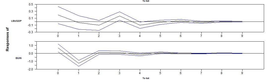

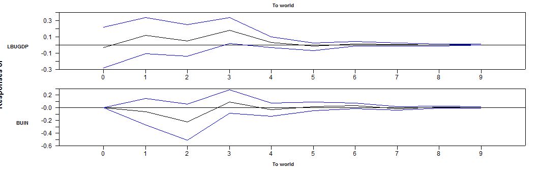

... and why are BuIn responses from W-shocks bound to 0 in the the first period (happens for any country model), but is not the case for TOT-shocks... It shouldnt be bound to 0 ideally, or is there a reason why it is like that?!
- W-shocks.JPG (47.33 KiB) Viewed 22529 times
- tot-shocks.JPG (47.4 KiB) Viewed 22529 times
Re: importance of exogenous regressor in VAR
Probably the W coefficient in the BUIN equation is close to zero.
You're obviously doing a different program than what you posted above, since that has four endogenous variables. Please post your program and data.
You need to substitute out the ECT's while doing the IMPULSE instruction:
impulse(print,model=%modelsubstect(vecmodel)+worldeq,shocks=%unitv(%nvar+1,%nvar+1),$
result=impulses,steps=nstep)
(adding the %MODELSUBSTECT() around the VECMODEL.) Note also that the INCLUDE on @MCGRAPHIRF is based upon position, not name. In your case, it ends up not mattering since the model uses the 4 endogenous variables in their original order, but you should change that to ||2,4|| or whatever is correct.
