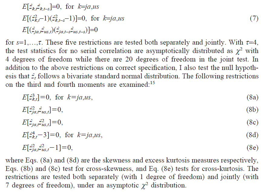

Dear Tom, Thanks for the explanation. I have uploaded the specification test section.
- Specification test
- Untitled.gif (57.51 KiB) Viewed 20911 times
Re: Angela Ng 2000 JIMF
I'm not sure what that has to do with your previous question. Given the z-hats, you do the tests (individually and jointly) as I described above. Nothing in what you posted describes how *she* computes the z-hats. I assume that she's doing some form of joint standardization. There are many (reasonable) ways to do that, and each will give somewhat different results.
