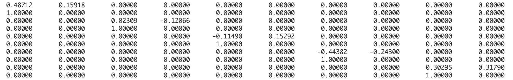

Note that D1 sits on top of a 4x4 identity matrix. So if I expand this out I get the 10x10 matrix:
which makes sense given the vectors C*t and U*t, which looks like [Ct Ct-1 U1t U2t U3t U4t U1t-1 U2t-1 U3t-1 U4t-1]. The transition matrix from example 6.1 is:

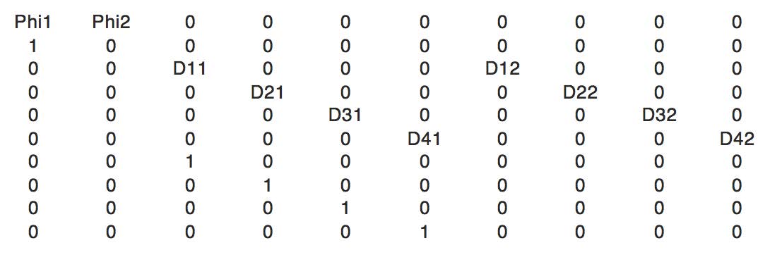

I am just not seeing that identity matrix or the diagonals matrices. But if I look at this example:
starts to make sense if I reorder the C*t and U*t vector as [Ct Ct-1 U1t U1t-1 U2t U2t-1 U3t U3t-1 U4t U4t-1]. I think other matrices are re-ordered accordingly.
So any idea of what where I am getting lost?
Re: Stock Watson Example
Sorry. You're correct. They blocked the D's differently. RATS does a block diagonal with separate 2x2 matrices for each of the U components, so they're blocked by component. S&W blocks by lag. While the two are equivalent, the former is, I think, much easier. For instance, it's quite a bit simpler to vary the lag length of the components. In the S&W setup you would probably need to extend all polynomials out to the maximum lag (with zeros if necessary), or you would lose the structure.
