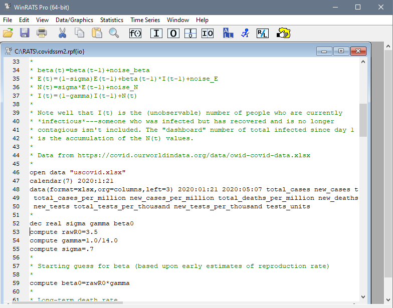

This is a preliminary example of syntax highlighting. (The comments are in green, quoted strings in red; an unclosed quoted string will be red underline). This also shows what this looks like with line numbers.
One minor issue is with the fact that RATS has both input and output windows (and sometimes single windows have both). I'll try to look into how easy it would be to style output differently from program statements.
These would all be set up to be optional with colors that can be selected by the user. Suggestions are welcome.
Screen shot with syntax highlighting
syntax highlight.png (45.82 KiB) Viewed 114477 times
