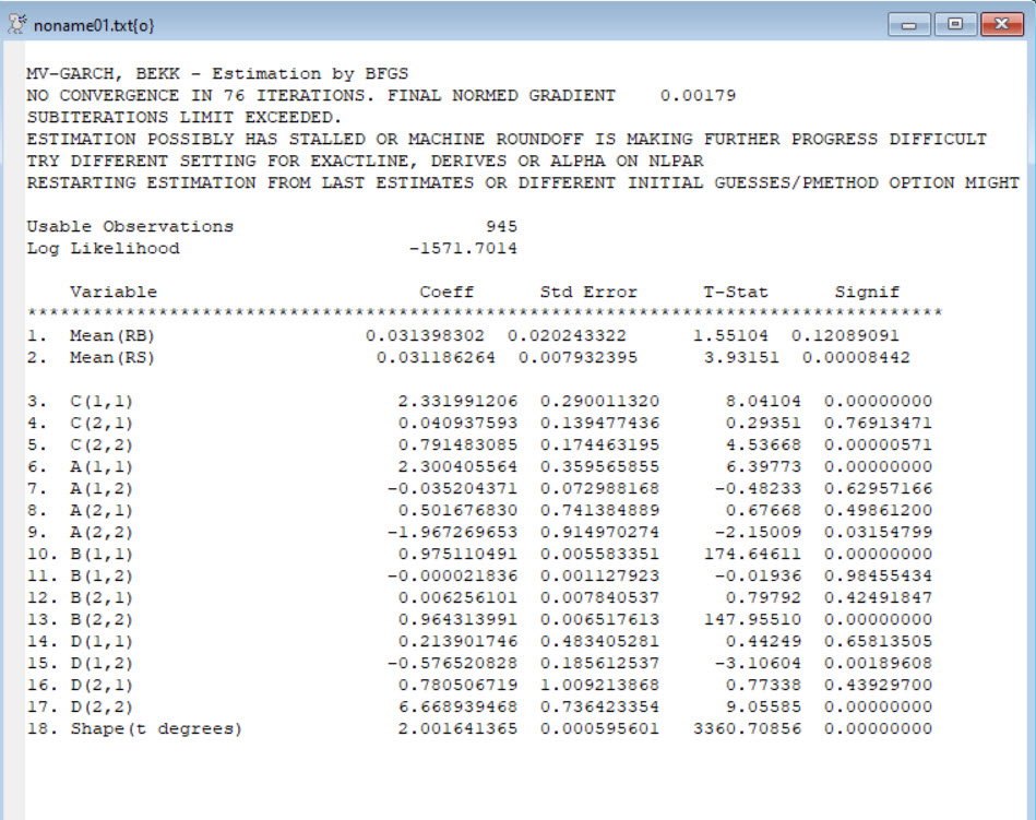

Re: Structure Break in Variance Equation of MGARCH
Posted: Sun Dec 13, 2020 11:20 am
by prashantj
I am sorry but this is the output I am getting. I did multiply returns with 100. It says no convergence. Any suggestions? please
