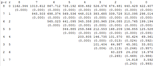

I have a model with 9 variables. 8 of those variables are I(1) and one is I(2). When I estimated, I got the attached result.
Am I correct to conclude that the rank is 5?

According to their procedure (move left to right and top to bottom starting at the top left), you would get s2=2 and r=5. However, if you think there's just one I(2) trend, then you would just run down that column to get r=5.
