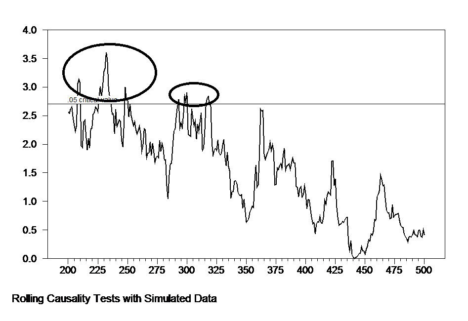

Dear Mr.Doan,
This is the code for what I want to test. Thank you very much. But this code makes me more curious.
Let me ask you 2 questions about this. Please see the attached graph file.
Question 1.
As you can see, some parts of the graph (2 circles in the initial part) have significant F values, which you referred to 'changes in causality'. In testing with real data, unlike your virtual and spurious causality example, this kind of result - that is to say, some parts are significant, but another parts are not - could be given to us. In this case, should we judge whether there is causality or not 'by the number of tips (F values over critical value) of entire iceberg (total number of F values)?
Question 2.
As in usual full sample Granger causality test, I think that the rolling causality shows only the causality direction. So, if I want to know how much varible X influence variable Y, I need to test simple regression, VAR, etc., right?

I think you're missing the point. There is no causality at all in this example---the two series are generated independently. What you observe in the graph is all sampling error in the F statistic. The problem with most "rolling sample" analyses is that they treat the estimates like they're data, and interpret them without regard to how they're affected by sampling error.

OK! I could summarize your tonight teaching as below.
1. Rolling regression output can shows whether their relationship are stable or not.
2. Each window generates different F values and some windows' F values comes in significant confidence interval. BUT THIS DOES NOT MEAN ALWAYS THAT THERE ARE SIGNIFICANT CHANGES IN THE PROCESS. So, in case of YOUR example, we cannot judge that the 2 circles in the graphs means true changes.
Please check my summary.
Let me ask you one more thing. Then, how should I interprete the graph of your example in the aspect of 'stability in relationships'? The number of tips (F values over critical value) of entire iceberg (total number of F values) are the key indicators? The more the number of tips, the less stable the relationship between X and Y

No. No. No. Again, please remember that in that example, the true value at every single entry is zero. Everything that you see in that graph, every peak, every valley, every zig, every zag is solely due to the effect of running the regression on a particular subsample. If you drill into the data you find that there are a few places where a big value of Y (randomly) precedes a big value of X---when a moving window includes those, it generates a high Y to X "causality" test, and when a window moves off of those, the causality test value drops (sometimes rather quickly). Even though there really is no actual difference.

Then, your words seems to mean that the line in the example graph does not mean anything. If this is true, your example just warns that we should not misjudge the spurious causality relationship produced by the rolling causality test. Then, what is the purpose of doing rolling causality test? You said that "There's nothing wrong with testing for stability in relationships". So, I asked before how can I use the rolling causality test to judge whether the relationship between 2 variables are stable or not. Your ROLLINGCAUSALITY.RPF plays just a role for showing spurious causality example and does nothing else?

There is a literature on rolling causality tests. I've yet to see a published paper on it that (in my opinion) is proper statistical practice. Sometimes bad statistical practice makes it into the literature. We wrote this program to show people how to do it if they must, but to warn why it's a bad idea.
There are many different tests for stability---fluctuation tests, A-P tests, CUSUM tests, etc. All of those produce graphs that at least superficially look like the "rolling causality test" graphs. However, those have a specific global null hypothesis and the graphs for different time periods have a specific meaning relative to that. It's not clear what any changes in rolling causality test graphs actually mean.
