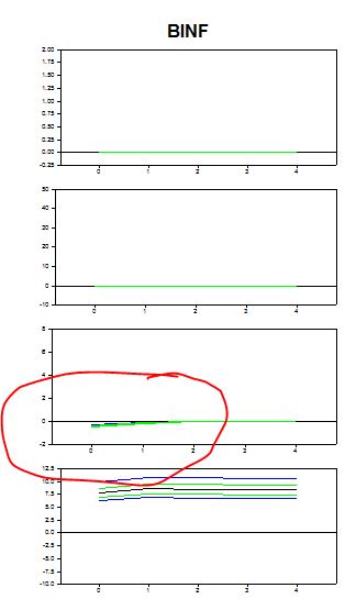

The excel output is correct now. With "b" the code also runs through, BUT it does not change the IRF of a demand shock on output as wanted to make the effect positive. Could you help me out there again. Then I will be satisfied. Thanks a lot for all your help!You're using B where the other program used FACTOR.

if b(3,4)<0.0
compute b=b*%diag(||1.0,1.0,1.0,-1.0||)

Re: Near VAR with Long Run restriction
You have to do the sign flip inside the loop as well.
