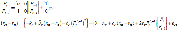

That requires augmenting the state vector with a lag of F since it's F(t-1) that enters into the measurement equation, not F(t). The state and (linearized) measurement equation are:
In the measurement equation, the first term on the right in {...} is the "MU", and the matrix in [...] is the C. Both of those depend upon the expansion point, which I've written as F^{*,-1}_t. The paper says it's doing the expansion around the expectation of F(t-1|info through t-2), but you actually can use the expectation of F(t-1|info through t-1), since this is being evaluated at t, so all information through t-1 is a valid input. (That's why I chose a rather odd notation, to make clear that this is a time t calculation).
You can compute the expansion point as a side-effect of evaluating the CF function, as something like:
dec series[vect] xstates
clear(zeros) fexpand
frml cf = fexpand=%if(t==1,0.0,xstates(t-1)(2)),||0.0,otherstuff+2*bp*fexpand{0}||
The t==1 refers to the first entry in your estimation range, so you might need to change that. By definition, the pre-sample mean for F is zero. The "otherstuff" is all the terms in the C matrix which don't depend upon the expansion point. Use xstates as the state estimate parameter in your DLM instruction.
This is the TeX code for the description of the model above:

 \{ {r_{Pt}} - {r_{ft}}\}  = \left\{ { - {k_t} + {{\bar \beta }_P}\left( {{r_{mt}} - {r_{ft}}} \right) - {b_P}{{\left( {F_t^{*, - 1}} \right)}^2}} \right\} + \left[ {\begin{array}{*{20}{c}}
   0 & {{{\bar \alpha }_P} + {c_P}({r_{mt}} - {r_{ft}}) + 2{b_p}F_t^{*, - 1}}  \\
\end{array}} \right]\left[ {\begin{array}{*{20}{c}}
   {{F_t}}  \\
   {{F_{t - 1}}}  \\
\end{array}} \right] + {\varepsilon _{Pt}} \\
 \end{array}\]

You have to do *some* approximation, because you can't Kalman filter with the square of a state variable in the measurement equation.
