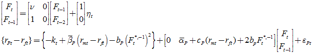

That requires augmenting the state vector with a lag of F since it's F(t-1) that enters into the measurement equation, not F(t). The state and (linearized) measurement equation are:
In the measurement equation, the first term on the right in {...} is the "MU", and the matrix in [...] is the C. Both of those depend upon the expansion point, which I've written as F^{*,-1}_t. The paper says it's doing the expansion around the expectation of F(t-1|info through t-2), but you actually can use the expectation of F(t-1|info through t-1), since this is being evaluated at t, so all information through t-1 is a valid input. (That's why I chose a rather odd notation, to make clear that this is a time t calculation).
You can compute the expansion point as a side-effect of evaluating the CF function, as something like:
dec series[vect] xstates
clear(zeros) fexpand
frml cf = fexpand=%if(t==1,0.0,xstates(t-1)(2)),||0.0,otherstuff+2*bp*fexpand{0}||
The t==1 refers to the first entry in your estimation range, so you might need to change that. By definition, the pre-sample mean for F is zero. The "otherstuff" is all the terms in the C matrix which don't depend upon the expansion point. Use xstates as the state estimate parameter in your DLM instruction.

 \{ {r_{Pt}} - {r_{ft}}\}  = \left\{ { - {k_t} + {{\bar \beta }_P}\left( {{r_{mt}} - {r_{ft}}} \right) - {b_P}{{\left( {F_t^{*, - 1}} \right)}^2}} \right\} + \left[ {\begin{array}{*{20}{c}}
   0 & {{{\bar \alpha }_P} + {c_P}({r_{mt}} - {r_{ft}}) + 2{b_p}F_t^{*, - 1}}  \\
\end{array}} \right]\left[ {\begin{array}{*{20}{c}}
   {{F_t}}  \\
   {{F_{t - 1}}}  \\
\end{array}} \right] + {\varepsilon _{Pt}} \\
 \end{array}\]

You have to do *some* approximation, because you can't Kalman filter with the square of a state variable in the measurement equation.
