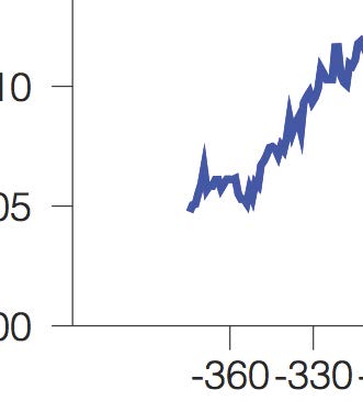

That's what I tried first...when I run this code this is what I get:

You would have to post the program and data set. I can't reproduce that.

It just the code you posted. I attached entire chart this time. I ran the code on versions 8.3 and 9.00b. Same result. MacOS X Yosemite.

Download the newest build. It should work correctly. 9.00b was the first v9 for the Mac---we had several fixes since then.
