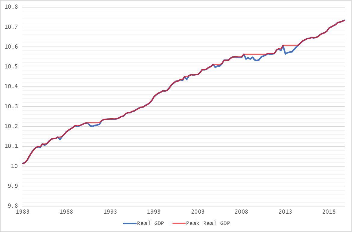

Concerning the K&V problem itself, I thought we may split the real energy price series following Shin et al. (2013) - "Modelling Asymmetric Cointegration and Dynamic Multipliers in a Nonlinear ARDL Framework", in terms of cumulative partial sum. I attach an excel file in which PARSUM_POS and PARSUM_NEG represent the cum. part. sum of the real energy price. In this case, could we estimate the model in levels?
Yes, I wanted to write "potentially cointegrated" instead "potentially integrated". Typo!That's true only if the variables are cointegrated.
Probably the best thing is to openly think about another economic problem with different variables. Suppose we have the real GDP per capita and the consumption expenditure per capita (cointegrated). Could we consider the "peak real gdp" (as the attached image displays) as the XPLUS variable in the K&V methodology to estimate the model in levels?I'm not sure what you mean by "all the observations in which the energy price increases or remains constant".

cancla
