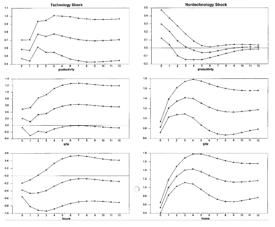

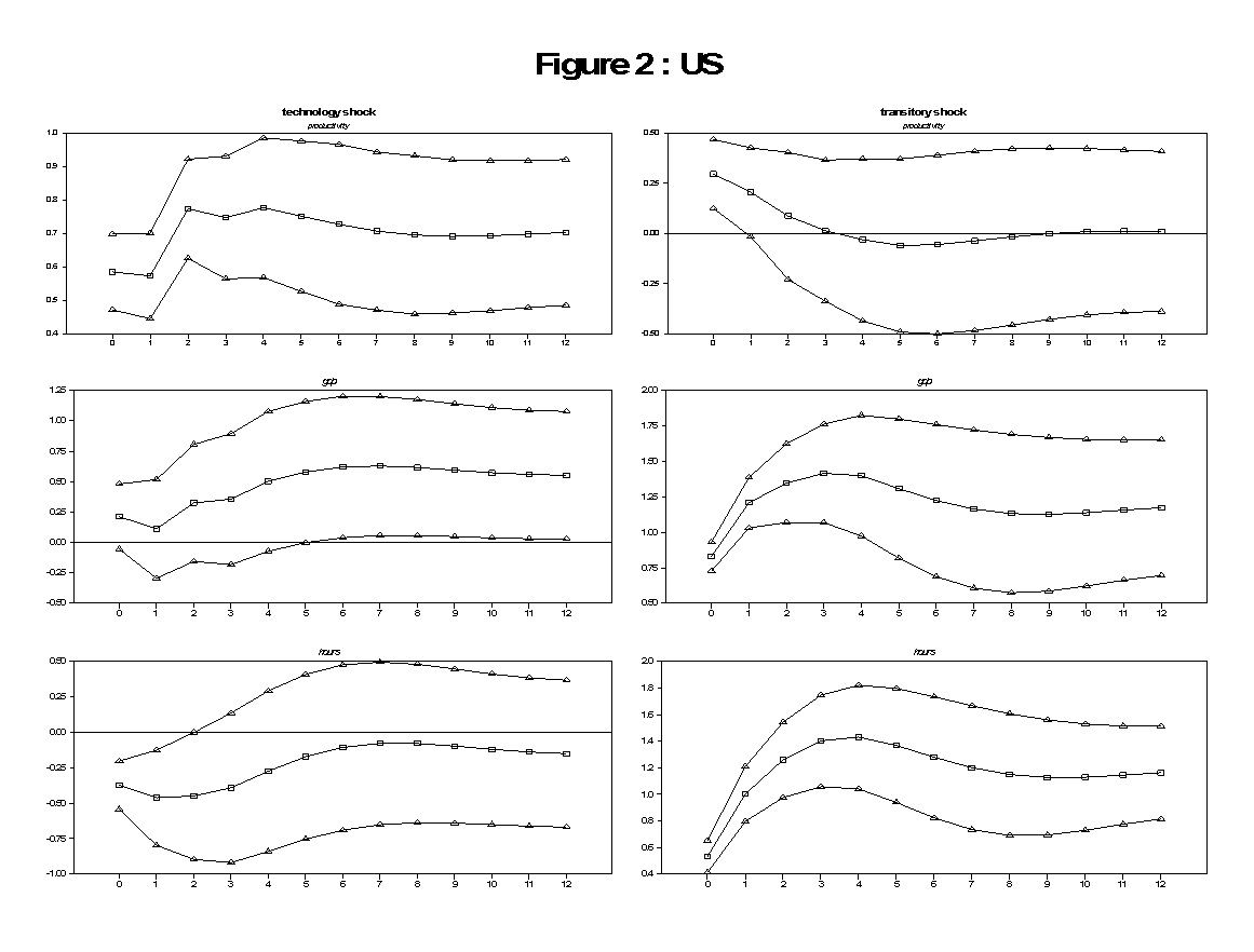

I ran the package available at http://ideas.repec.org/c/boc/bocode/rtz00062.html as suggested by TomDoan. It runs fine producing the correct results. However, the impulse response of non-technology shocks on productivity is not right. (Graphs below.)
Do you have any idea why this might me be the case?
Many thanks.
Many thanks.

You'll note that the center response matches up so it's a question about the error bands. The program includes calculations of error bands both using the delta method (which are the ones labeled with the "Figure 2" and "Figure 3") and Monte Carlo integration (which are earlier ones which aren't labeled). The two give relatively similar answers in the modernized RATS code, so it's possible that there was some minor computational error in the empirical work in the paper which made the error bands too narrow.Benedek11 wrote:Hi,
