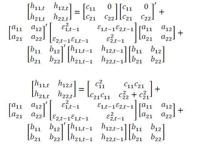

I got the point. For a bekk(1,1) model, we have:
And when there is a dummy variable we just add C and dummy matrices and then multiply them out.
Re: Multivariate GARCH model with dummies
Correct. c(1,1)+d(1,1) x dummy,0|c(2,1)+d(2,1) x dummy,c(2,2)+d(2,2) x dummy replaces the C matrix, and you multiply that out.
